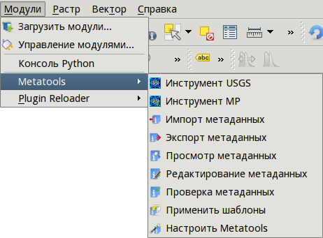

After installation plugin will create two toolbars and add submenu in the «Plugins» menu.
Plugin toolbars
Metatools in menu

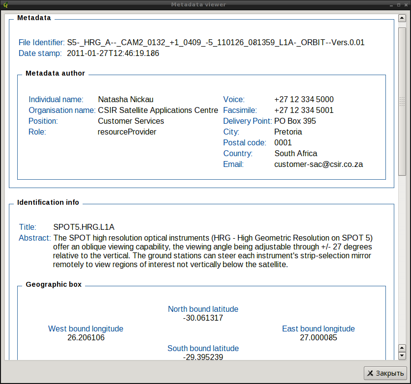

Viewing metadata is implemented via translating it into html-representation. This makes it easy to change the appearance of the output just by editing the xslt conversion file. Conversion files are stored in the xsl directory of the plugin folder, for example in ~/.qgis/python/plugins/Metatools/xsl/. To edit these files you need only basic knowledge of the XSLT language and your favorite text editor. Here how standard appearance looks:
Metadata viewer
You can copy all or only selected metadata from context menu, and then paste it as plain text or HTML into another editor. Also from this menu it is possible to print metadata.

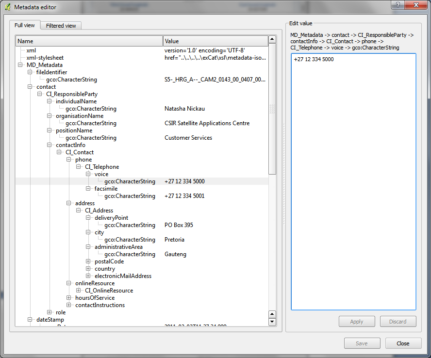

Metadata editor has two modes: displaying full metadata tree («Full view»):
Metadata editor (full view)

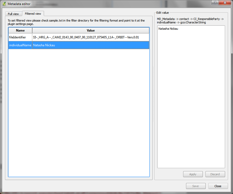

and displaying only favorite nodes («Filtered view»):
Metadata editor (filtered view)
Filtered approach allows quick editing of some predefined nodes (for example, the filter can be used for quick access to the most used fields), and modify all other fileds by searching them in full tree.
You can create as many filters as you need, current filter can be selected in the plugin settings. Filter definition is stored as plain text, so to create new filter you should create new text file and fill it with necessary node path (one node in each line). Here is an example:

To find node path: open editor in «Full view» mode, select necessary node and in right side above edit area you will see full node path. You can copy it to clipboard from context menu.
This path (except type identifier) will be desired filter line. For example, node path may look like this:
MD_Metadata -> dateStamp -> gco:Date
the last part (gco:Date) — is a type indentifier, and should be ommited. So, in the filter file you should paste this string:
When you finished, save file where you want and in settings dialog select it as «Filter file».

To edit a node, select it in the left side of the editor window, node value will be displayed in the «Edit value» field in the right side of the window, where you can change it. Pressing the «Apply» button will update metadata. To undo your edits press «Discard» button. Warning! All changes are stored in memory, to save edits on disk you need to press «Save» button.

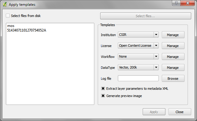

For the convenience of preparing metadata for a large number of layers plugin provides a template mechanism. Once filling information about institution, license, workflow and data type you can apply this information to several layers at once.
Note: currently templates works only with metadata in ISO19115 format, support of the FGDC standard is upcoming.
Applying templates to layers

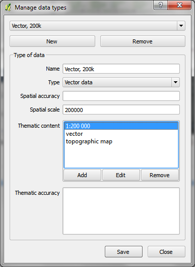

You can create as many templates as you need, to manage templates press «Manage» button
Manage DataType templates
All templates are stored in the subfolders of the templates folder under plugin path.

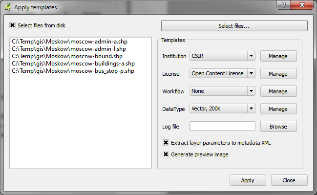

In addition to applying templates to the layers in layers list, it is possible to apply templates to the external datasets without loading them in QGIS. To do this check «Select files from disk» checkbox and select necessary files.
Applyin templates to files

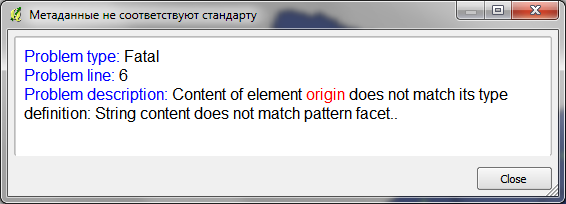

Validate metadata
Validate metadata

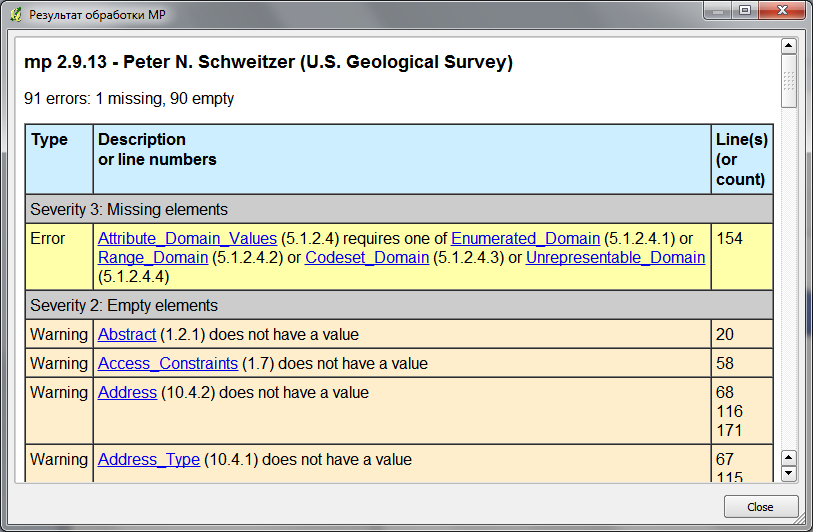

This tool is used for metadata file validation (checking for compliance with selected standard). It is under development and currently supports only FGDC standart and produces ugly and mainly nonreadable reports.
Metadata validation results

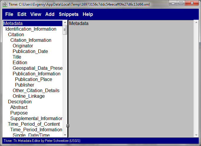

Since several functions for complete FGDC support are still unimplemented we've include two external tools: USGS Tkme  — editor for FGDC metadata by Peter N. Schweitzer and mp  — metadata validator. These tools can be accessed using toolbuttons:
USGS Tkme — USGS Tkme
USGS mp — USGS mp
This utilities will help you edit metadata documents according with the FGDC requirements and validate existing metadata files. You can run them directly from QGIS to handle metadata of the layers.
Editing with Tkme
Validating with mp

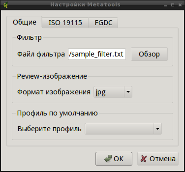

Here you can setup filter for editor «Filtered view» mode, preview files format, default metadata profile and view stylesheets.
Configure plugin
