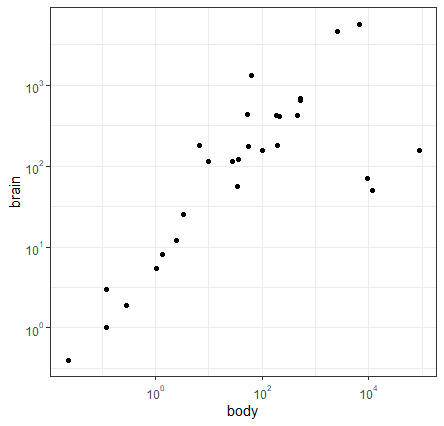

> library(MASS) # to access Animals data sets
> library(ggplot2)
> library(scales) # to access break formatting functions
> sessionInfo()
other attached packages:
[1] ggplot2_3.3.0 scales_1.1.0  MASS_7.3-51.4
> # x and y axis are transformed and formatted
> p2 <- ggplot(Animals, aes(x = body, y = brain)) + geom_point() +
+   scale_x_log10(breaks = trans_breaks("log10", function(x) 10^x),
+                 labels = trans_format("log10", math_format(10^.x))) +
+   scale_y_log10(breaks = trans_breaks("log10", function(x) 10^x),
+   theme_bw()
> # log-log plot without log tick marks
> p2
