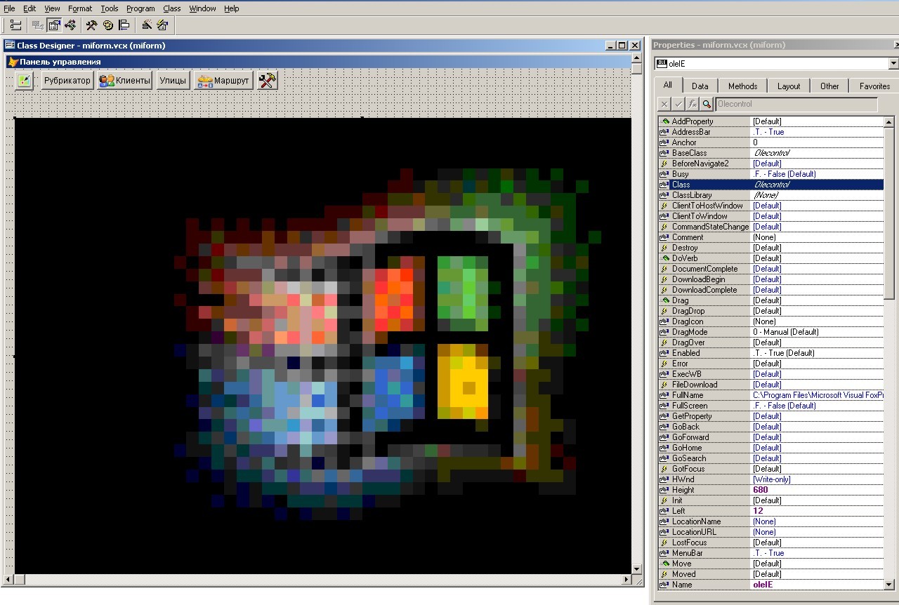

Рабочий пример совместной работы Visual studio и OL:
PROCEDURE F3GOROD
   SELECT KATPER
   XBMPFILE=BMPFILE
   XCODEKART=CODEKARTA
   TIK7=2
   XF3GOROD=0
SCATTER MEMVAR
SET DECIMALS TO 18
pipi=3.141592653589793238462
M.Long = M.Long * 20037508.34/180
M.Lat = log(tan((90 + M.Lat) * pipi / 360)) / (pipi / 180)
M.Lat = M.Lat * 20037508.34 / 180
TEXT TO lcHtml NOSHOW TEXTMERGE
<!DOCTYPE html PUBLIC "-//W3C//DTD XHTML 1.0 Strict//EN" "http://www.w3.org/TR/xhtml1/DTD/xhtml1-strict.dtd">
		<html xmlns="http://www.w3.org/1999/xhtml">
		  <head>
		    <title>Смоленск</title>
		    <meta http-equiv='imagetoolbar' content='no'/>
		    <style type="text/css"> v\:* {behavior:url(#default#VML);}
		        html, body { overflow: hidden; padding: 0; height: 100%; width: 100%; font-family: 'Lucida Grande',Geneva,Arial,Verdana,sans-serif; }
		        body { margin: 10px; background: #fff; }
		        h1 { margin: 0; padding: 6px; border:0; font-size: 20pt; }
		        #header { height: 43px; padding: 0; background-color: #eee; border: 1px solid #888; }
		        #subheader { height: 12px; text-align: right; font-size: 10px; color: #555;}
		        #map { height: 95%; border: 1px solid #888; }
		    </style>
		    <script src="file://localhost/c:/_transport/OpenLayers-2.9.1/OpenLayers-2.9.1/lib/OpenLayers.js"    type="text/javascript"></script>
		    <script type="text/javascript">
		        var map;
			    var mapBounds = new OpenLayers.Bounds( 3510928.9959, 7298658.69525, 3598060.05994, 7360004.41386);
			    var mapMinZoom = 0;
			    var mapMaxZoom = 9;
		        // avoid pink tiles
		        OpenLayers.IMAGE_RELOAD_ATTEMPTS = 3;
		        OpenLayers.Util.onImageLoadErrorColor = "transparent";
		        function init(){
	            var options = {
	                controls: [],
		            maxExtent: new OpenLayers.Bounds(  3510928.9959, 7298658.69525, 3598060.05994, 7360004.41386 ),
		            maxResolution: 393.645920,
		            numZoomLevels: 10
	            map = new OpenLayers.Map('map', options);
		        var layer = new OpenLayers.Layer.TMS( "TMS Layer","file://localhost/c:/_map2010/sm_mercat84/",
		            {  url: '', serviceVersion: '.', layername: '.', alpha: true,
						type: 'png', getURL: overlay_getTileURL
		        map.addLayer(layer);
				map.zoomToExtent( mapBounds );
	            map.addControl(new OpenLayers.Control.PanZoomBar());
	            map.addControl(new OpenLayers.Control.MousePosition());
	            map.addControl(new OpenLayers.Control.MouseDefaults());
	            map.addControl(new OpenLayers.Control.KeyboardDefaults());
                map.setCenter(new OpenLayers.LonLat(<<ALLTRIM(STR(M.Long,12,6))>>,
                <<ALLTRIM(STR(M.Lat,12,6))>>),<<TRANSFORM(8)>>);
           // allow testing of specific renderers via "?renderer=Canvas", etc
            var renderer = OpenLayers.Util.getParameters(window.location.href).renderer;
            renderer = (renderer) ? [renderer] : OpenLayers.Layer.Vector.prototype.renderers;
             var vectorLayer = new OpenLayers.Layer.Vector("Simple Geometry", {
                styleMap: new OpenLayers.StyleMap({'default':{
                    strokeColor: "#00FF00",
                    strokeOpacity: 1,
                    strokeWidth: 3,
                    fillColor: "#FF5500",
                    fillOpacity: 0.5,
                    pointRadius: 4,
                    pointerEvents: "visiblePainted",
                    label : " ${nam1}",
                    fontColor: "${favColor}",
                    fontSize: "14px",
                    fontFamily: "Courier New, monospace",
                    fontWeight: "bold",
                    labelAlign: "${align}",
                    labelXOffset: "${xOffset}",
                    labelYOffset: "${yOffset}"
                renderers: renderer
            // create a point feature
            var point = new OpenLayers.Geometry.Point(<<ALLTRIM(STR(M.Long,12,6))>>,<<ALLTRIM(STR(M.Lat,12,6))>>);
            var pointFeature = new OpenLayers.Feature.Vector(point);
            pointFeature.attributes = {
                nam1: "<<strconv(ALLTRIM(m.name),9,1049)>>",
                favColor: 'red',
                align: "cm",
               // positive value moves the label to the right
                xOffset: 60,
                // negative value moves the label down
                yOffset: -15
            map.addLayer(vectorLayer);
            vectorLayer.addFeatures([pointFeature]);
	        function overlay_getTileURL(bounds) {
	            var res = this.map.getResolution();
	            var x = Math.round((bounds.left - this.maxExtent.left) / (res * this.tileSize.w));
	            var y = Math.round((bounds.bottom - this.maxExtent.bottom) / (res * this.tileSize.h));
	            var z = this.map.getZoom();
				if (x >= 0 && y >= 0) {
		            return this.url + z + "/" + x + "/" + y + "." + this.type;
				} else {
	                return "http://www.maptiler.org/img/none.png";
		   function getWindowHeight() {
		        if (self.innerHeight) return self.innerHeight;
		        if (document.documentElement && document.documentElement.clientHeight)
		            return document.documentElement.clientHeight;
		        if (document.body) return document.body.clientHeight;
			        return 0;
		    function getWindowWidth() {
			    if (self.innerWidth) return self.innerWidth;
			    if (document.documentElement && document.documentElement.clientWidth)
			        return document.documentElement.clientWidth;
			    if (document.body) return document.body.clientWidth;
			        return 0;
		    function resize() {
			    var map = document.getElementById("map");
   		        map.style.height = (getWindowHeight()-10) + "px";
			    map.style.width = (getWindowWidth()-10) + "px";
				if (map.updateSize) { map.updateSize(); };
		    onresize=function(){ resize(); };
		    </script>
		  </head>
		  <body onload="init()">
		    <div id="map" style="height: 700px; z-index: 1; width: 990px; position: absolute; top: 3px; left: 200px;"></div>
		  </body>
		</html>
    ENDTEXT
    STRTOFILE(lcHtml,"MiHtml.htm")
     THISFORM.oleIE.Navigate2(FULLPATH("MiHtml.htm"))
  IF XXSPRAV=3
     SELECT katper
  ENDIF
RETURN

Не силен в VisualStudio и OLE, но это
видимо используется для отображения скрипта. В Delphi так не получится, вроде как?.. А проект д.б. выполнен именно там. Там кроме TWebBrowser ничего подходящего не знаю...

В двух словах в приведенном выше тексте на форме создан OLE Control к Internet Explorer.
Все это с рождения было в Delphi.

По примеру дошло с трудом, просто, что ActiveX компонент TWebBrowser это потомок OleControl, у меня-то не Visual studio, в моей среде он именно как TWebBrowser в свойствах значится, в чистом виде OleControl там нет. Ну, так или иначе, если в тот же TWebBrowser загружать файл посредством Navigate2, все отображается правильно:
var
Src : OleVariant;
Src:='file:///E:/DOCUMENTS/COOP/FOR_OFFER_WEBMAP/EX_OSM/test.html';
//позже доработаю, FULLPATH тут не доступен
wbMain.Navigate2(Src);
А большего, вроде, и не надо. Да, и спасибо за ссылки, честное слово, искал по сайту, не додумался именно ГИС с delphi ввести) Просто задача так не стоит - какую выбрать ГИС, это определено жестко, да и использовать какие-то специализированные компоненты, позволяющие аналог 2gis сделать - как из пушки по воробьям тут.
