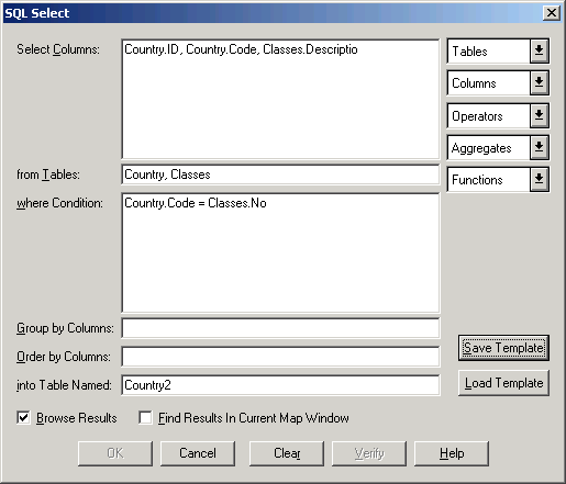

SQL Queries 1
In fisrt sample we shall add new field.
I have a map layer ‘Country’ with the attribute table of the sort
and I have a table ‘Classes’ of all code meanings:
Let's apply SQL query:
[Query] → [SQL Select…]
(see picture below for details) and obtain ‘Country2’ table:
Let's save ‘Country2’:
[File] → [Save Copy As…]

- Country2.png (5.6 КБ) 8479 просмотров

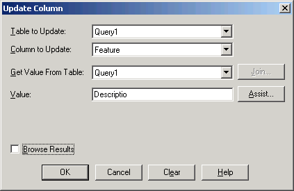

In second sample we shall fill existing field.
I have a map layer ‘Country’ with the attribute table of the sort:
(see picture below for details) and obtain ‘Query1’ table:
Now modify ‘Query1’ table filling ‘Feature’ column with ‘Descriptio’ values:
[Table] → [Update Column…]
(see second picture below for details).
Eventually save ‘Country’:
[File] → [Save Table…]

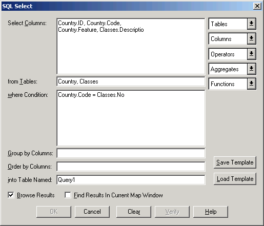

- Query1.png (5.67 КБ) 8478 просмотров
- UpdateColumn.png (3.57 КБ) 8478 просмотров
