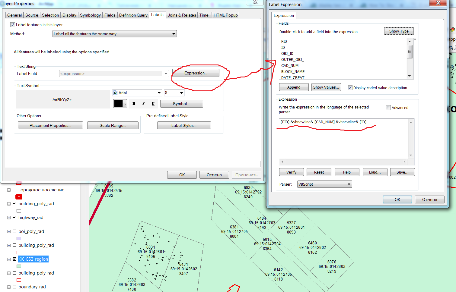

Vadim
[Field2] &vbnewline& [Field1] &vbnewline& [Field3
