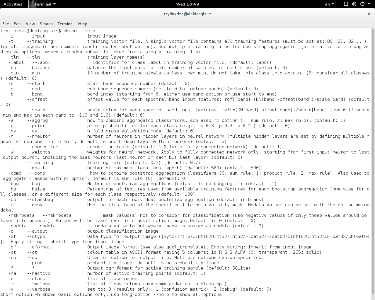

http://pktools.nongnu.org/html/md_insta ... all_manual
sudo apt-get install g++ make libgdal-dev libgsl0-dev libarmadillo-dev
http://pktools.nongnu.org/html/md_insta ... tion_linux
sudo apt-get install pktools
Debian GNU/Linux 8 (jessie) 64-bit:
