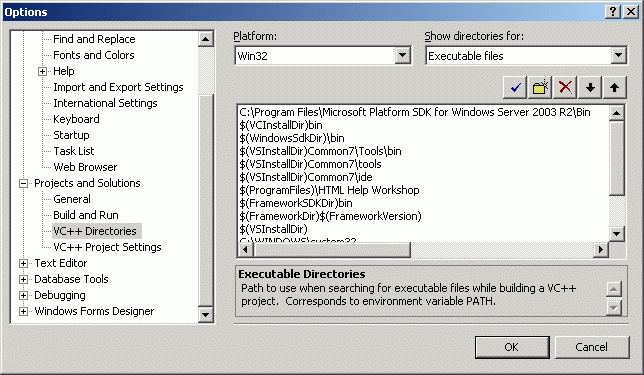

3. Добавим пути в настройки VCE.
Запустите Microsoft Visual C++ Express
Установите следующие пути в Tools-> Options-> Projects and Solutions-> VC++ Directories:
Executable files
c:\Program Files\Microsoft Platform SDK for Windows Server 2003 R2\Bin
Include files
C:\Program Files\Microsoft Platform SDK for Windows Server 2003 R2\Include
C:\Program Files\Microsoft Platform SDK for Windows Server 2003 R2\Include\atl
C:\Program Files\Microsoft Platform SDK for Windows Server 2003 R2\Include\mfc
Library files
c:\Program Files\Microsoft Platform SDK for Windows Server 2003 R2\Lib\
