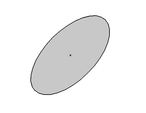

Пример:
v.buffer -c in=ell_pt out=ell_buf distance=10000 minordistance=5000 angle=45
