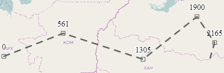

Сообщение Denis Rykov » 10 июн 2013, 07:04
(function() {
var map = new OpenLayers.Map('map');
var base_layer = new OpenLayers.Layer.OSM();
var measure_nodes = new OpenLayers.Layer.Vector();
var measure_config = {
'nodes_symbolizer': {
pointRadius: 4,
fillOpacity: 1,
strokeWidth: 1,
strokeOpacity: 1,
fillColor: "white",
graphicName: "square",
strokeColor: "#333333",
label: "${measure}",
labelYOffset: 20,
labelOutlineColor: "white",
labelOutlineWidth: 3
'path_symbolizer': {
strokeWidth: 3,
strokeOpacity: 1,
strokeColor: "#666666",
strokeDashstyle: "dash"
measure_nodes.styleMap = new OpenLayers.StyleMap(measure_config.nodes_symbolizer);
var measure_control = new OpenLayers.Control.Measure(
OpenLayers.Handler.Path,
geodesic: true,
callbacks: {
'create': function() {
measure_nodes.removeAllFeatures();
'point': function(p,l) {
var node = new OpenLayers.Feature.Vector(p.clone());
node.attributes.measure = measure_control.getLength(l, 'km').toFixed(0);
measure_nodes.addFeatures([node]);
handlerOptions: {
layerOptions: {
styleMap: new OpenLayers.StyleMap(measure_config.path_symbolizer)
map.addLayers([base_layer, measure_nodes]);
map.addControl(measure_control);
measure_control.activate();
map.zoomToMaxExtent();
DEMO
Еще пример реализации: http://www.chamaps.com/watervliet/
