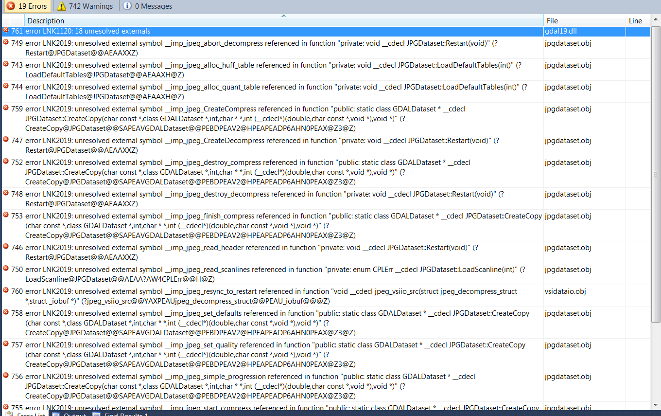

But, at the last step, which was buidling GDAL, it didn't compile, and I got bunch of errors.
Could you please look at the snapshot that I included, and see if you can spot something wrong with it?

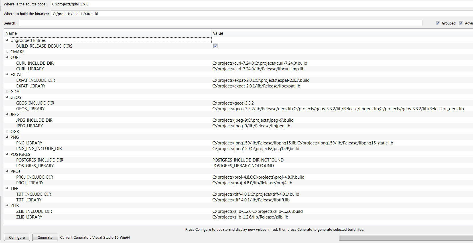

Also, some of the libraries like GEOS has few libraries, "geos.lib", "libgeos.lib", and "c_geos.lib".
Does it look like that I added them correctly? Do I need to include all of them individually? (please look the snapshot that I provided).
Do I need to somehow add all the "dll" into the final GDAL library as well?
And, one other thing that gave me an error in cmake was that I have to NOT list "C:\projects\geos-3.3.2\build", in GEOS_INCLUDE_DIR, and I only have to include "C:\projects\geos-3.3.2" !!!
When I listed "C:\projects\geos-3.3.2\build", I got the following error:
CMake Error at cmake/ogr.cmake:26 (get_filename_component):
get_filename_component unknown component C:\projects\geos-3.3.2\build
Call Stack (most recent call first):
CMakeLists.txt:110 (include)
So, I exclude "C:\projects\geos-3.3.2\build", and I have no more errors. But when I proceed with compiling gdallib.sln,
I got the following errors:
error C1083: Cannot open include file: 'curl/curl.h': No such file or directory
error C1083: Cannot open include file: 'expat.h': No such file or directory
error C1083: Cannot open include file: 'geos_c.h': No such file or directory
error C1083: Cannot open include file: 'proj_api.h': No such file or directory
error C1083: Cannot open include file: 'tiffio.h': No such file or directory

You need to fix some paths:
CURL_INCLUDE_DIR -> C:/project/curl-7.24.0/include
EXPAT_INCLUDE_DIR -> C:/project/expat-2.0.1/lib/
GEOS_INCLUDE_DIR -> C:/project/geos-3.3.2/include
GEOS_LIBRARY -> C:/project/geos-3.3.2/lib/Release/geos_c.lib
PROJ_INCLUDE_DIR -> C:/project/proj-4.8.0/src
TIFF_INCLUDE_DIR -> C:/project/tiff-4.0.1/libtiff;C:/project/tiff-4.0.1/build
PNG_LIBRARY -> C:/project/lpng159/lib/Release/libpng15.lib
You can copy the path from here and past them to cmake-gui.
The paths is so different, because this are the different projects, and they have their own point of view on sources and include paths.

Thanks again,
After fixing the above paths, I can see that I get passed the errors related to not being able to find a specific path. However, now I got bunch of LNK errors, that I have provided a snapshot for.
Am I still missing some stuff? Do I still need to include something else that I forgot about?
Thanks again in advance for your support.
(It looks like it is all regarding "jpgdataset.obj")
Here is the snapshot for the list of errors that I get:
- error.png (135.08 КБ) 15414 просмотров
