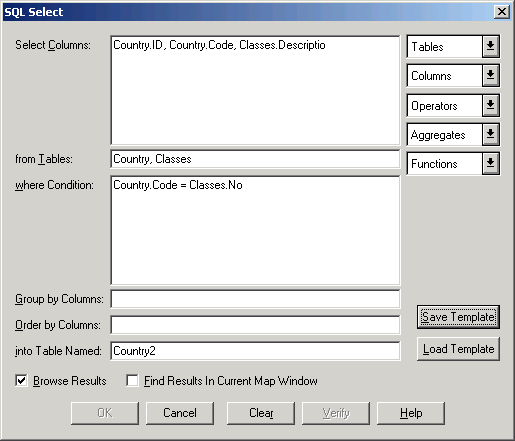

SQL Queries 1
In fisrt sample we shall add new field.
I have a map layer ‘Country’ with the attribute table of the sort
and I have a table ‘Classes’ of all code meanings:
Let's apply SQL query:
[Query] → [SQL Select…]
(see picture below for details) and obtain ‘Country2’ table:
Let's save ‘Country2’:
[File] → [Save Copy As…]
ID Code
1 2
2 3
3 1
4 1
5 2
6 2
No Descriptio
1 Water
2 Forest
3 Field
ID Code Descriptio
1 2 Forest
2 3 Field
3 1 Water
4 1 Water
5 2 Forest
6 2 Forest
- Country2.png (5.6 КБ) 8553 просмотра

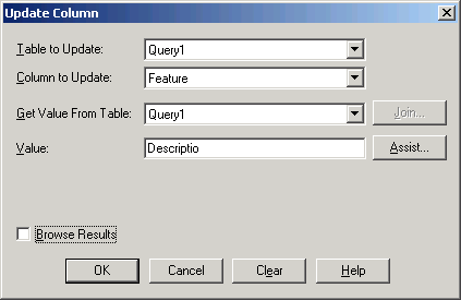

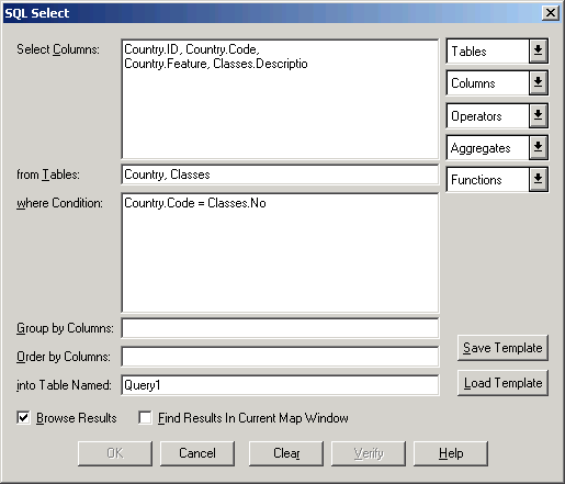

SQL Queries 2
In second sample we shall fill existing field.
I have a map layer ‘Country’ with the attribute table of the sort:
(see picture below for details) and obtain ‘Query1’ table:
Now modify ‘Query1’ table filling ‘Feature’ column with ‘Descriptio’ values:
[Table] → [Update Column…]
(see second picture below for details).
Eventually save ‘Country’:
[File] → [Save Table…]
ID Code Feature
1 2 NULL
2 3 NULL
3 1 NULL
4 1 NULL
5 2 NULL
6 2 NULL
No Descriptio
1 Water
2 Forest
3 Field
ID Code Feature Descriptio
1 2 NULL Forest
2 3 NULL Field
3 1 NULL Water
4 1 NULL Water
5 2 NULL Forest
6 2 NULL Forest
1 2 Forest Forest
2 3 Field Field
3 1 Water Water
4 1 Water Water
5 2 Forest Forest
6 2 Forest Forest
- Query1.png (5.67 КБ) 8552 просмотра
- UpdateColumn.png (3.57 КБ) 8552 просмотра
