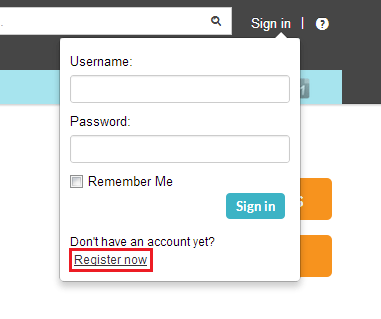

  1. From any page in the web interface, you will see a Sign in link. Click that link, and in the dialog that displays, click the Register now link. (if the Register Now link is missing try “admin” and “admin” for the Username and Password)

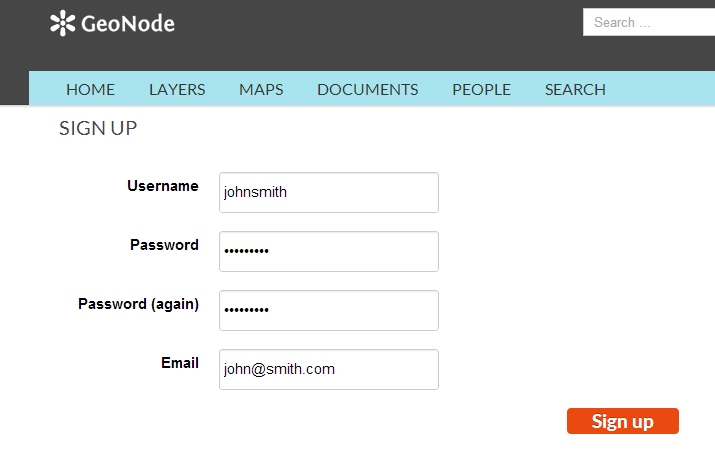

  2. On the next page, fill out the form. Enter a user name and password in the fields. Also, enter your email address for verification.
    ../../_images/geonode_signup10.png

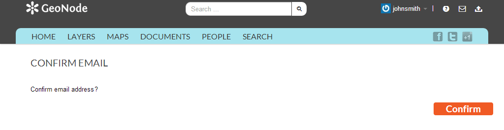

  3. You will be returned to the welcome page. An email will be sent confirming that you have signed up. While you are now logged in, you will need to confirm your account. Navigate to the link that was sent in the email.
    ../../_images/geonode_confirm10.png
  4. By clicking Confirm you will be returned to the homepage. Now you’ve registered an account, you are able to add layers to it as well as create maps and share those with other users.

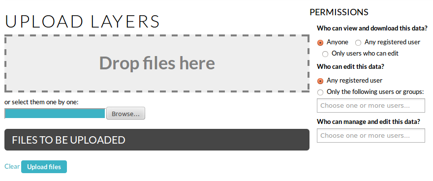

  3. Now click Upload Layers and you’ll see the upload form.
    ../../_images/geonode_uploadform_new_quickstart10.png

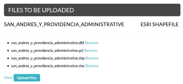

  4. You have two possibilities to add your files. You can either do that by using drag & drop or you choose to browse them. Be aware that you have to upload a complete set of files, consisting of a shp, a prj, a dbf and a shx file. If one of them is missing, GeoNode will warn you before you upload them.
  5. You shold now be able to see all the files you want to upload.
    ../../_images/geonode_files_to_be_uploaded10.png
  6. GeoNode has the ability to restrict who can view, edit, and manage layers. On the right side of the page you can see the Permission section, where you can limit the access on your layer. Under Who can view and download this data, select Any registered user. This will ensure that anonymous view access is disabled. In the same area, under Who can edit this data, select your username. This will ensure that only you are able to edit the data in the layer.
    ../../_images/geonode_permission10.png
  7. To upload data, click the Upload button at the bottom.

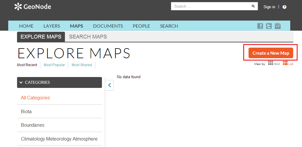

  1. Click the Maps link on the top toolbar. This will bring up the list of maps.
    ../../_images/geonode_maps_quickstart10.png
  2. Currently, there aren’t any maps here. To add one click the Create a New Map button and a map composition interface will display.

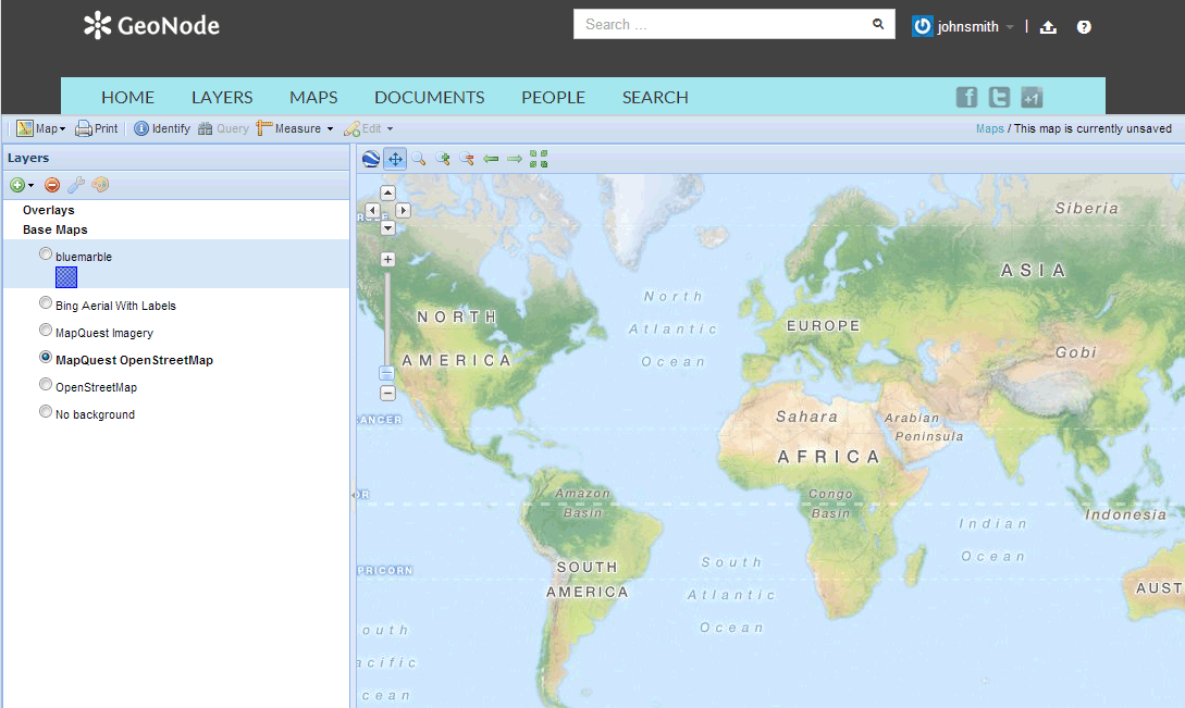

    In this interface there is a toolbar, layer list, and map window. The map window contains the MapQuest OpenStreetMap layer by default. There are other service layers available here as well: Blue Marble, Bing Aerial With Labels, MapQuest, and OpenStreetMap.

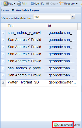

  3. Click on the New Layers button and select Add Layers.
    ../../_images/geonode_addlayerslink10.png
  4. Now you should be able to see all the availabel layers. In your case, this should only be the ones you’ve added before (San Andreas?).
  5. Select all of the layers by clicking the top entry and Shift-clicking the bottom one. Click Add Layers to add them all to the map.
    ../../_images/geonode_addlayersselect_quickstart10.png
  6. The layers will be added to the map. Click Done (right next to Add Layers at the bottom) to return to the main layers list.

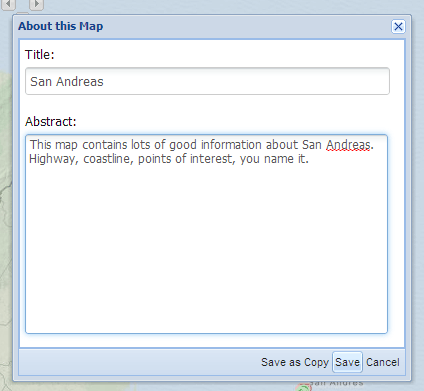

  8. Enter a title and abstract for your map.
    ../../_images/geonode_savemapdialog10.png

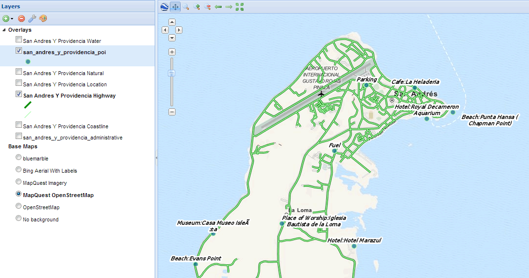

  1. Check the box next to the highway layer to activate it. If it is not below the POI layer in the list, click and drag it down.
    ../../_images/geonode_mapcomposition10.png

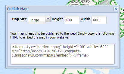

  5. A new dialog will appear with instructions on how to embed this map in a webpage, including a code snippet. You can adjust the parameters as necessary.
    ../../_images/geonode_publishmap10.png
