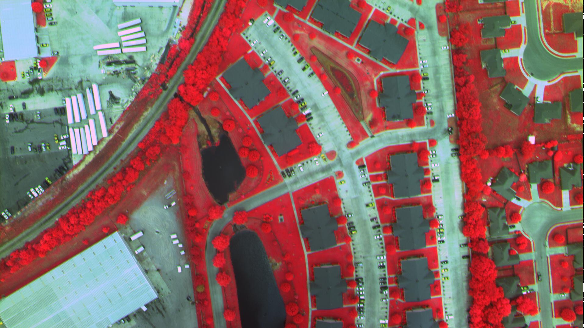

The WCPS query to access the full coverage is as follows:
for c in (NIR) return encode(c, "png")
Click on coverage to execute it on the browser.

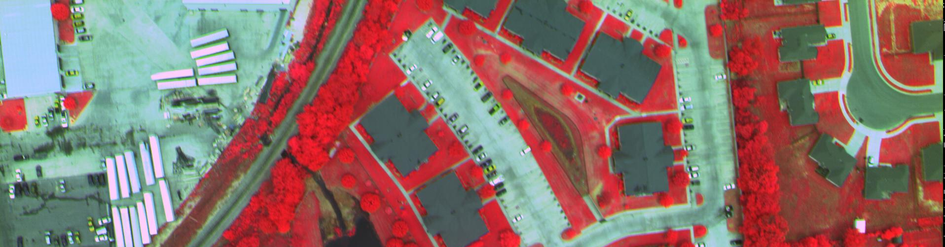

The WCPS query to access a subset of the coverage is as follows:
for c in (NIR) return encode(c[i(0:500),j(0:500)], "png")
Click on the subsetting to execute it on the browser.
The query result is an image as follows:

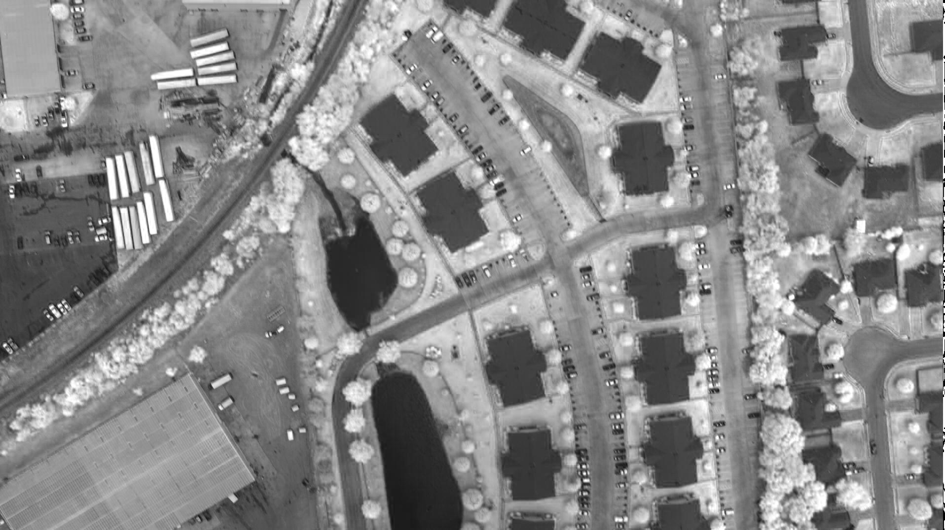

The WCPS query to access the red band of the coverage is as follows:
for c in (NIR) return encode(c.red, "png")
Click on band extraction to execute it on the browser.
You should see the following image in the browser:

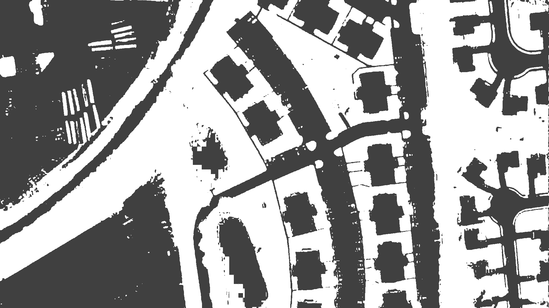

The NDVI (Normalized Difference Vegetation Index) is a measure for the probability of vegetation in remote sensing, i.e., the closer to +1 a pixel is, the more likely it is plants. The WCPS query to derive NDVI from the coverage is as follows:
for c in ( NIR ) return encode( ( (char) ( ( ( ((float)c).0-((float)c).1 ) / ( (float)c.0+((float)c).1 )) > 0 ) * 255), "png" )
