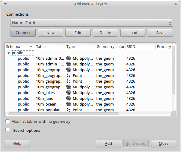

To produce a map from PostGIS data, you need a client that can get at the data. Most of the open source desktop GIS programs can do this - Quantum GIS, gvSIG, uDig for example. Now we’ll show you how to make a map from Quantum GIS.

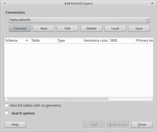

Start Quantum GIS from the Desktop GIS menu and choose Add PostGIS layers
from the layer menu. The
parameters for connecting to the Natural Earth data in PostGIS is already defined in the Connections
drop-down menu. You can define new server connections here, and store the settings for easy
recall. Hit Edit
if you want to see what those parameters are for Natural Earth, or just
hit Connect
to continue:
You will now get a list of the spatial tables in the database:

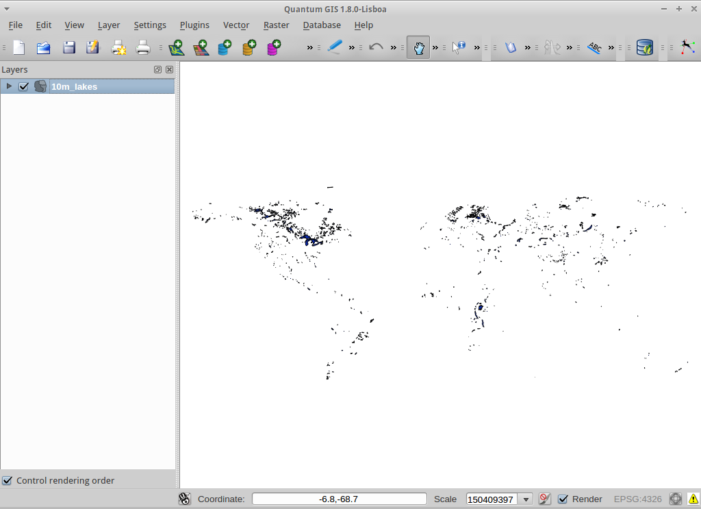

Choose the ne_10m_lakes table and hit Add
at the bottom (not Load
at the
top - that loads database connection parameters), and it should be
loaded into QGIS:
You should now see a map of the lakes. QGIS doesn’t know they are lakes, so might not colour them blue for you - use the QGIS documentation to work out how to change this. Zoom in to a famous group of lakes in Canada.

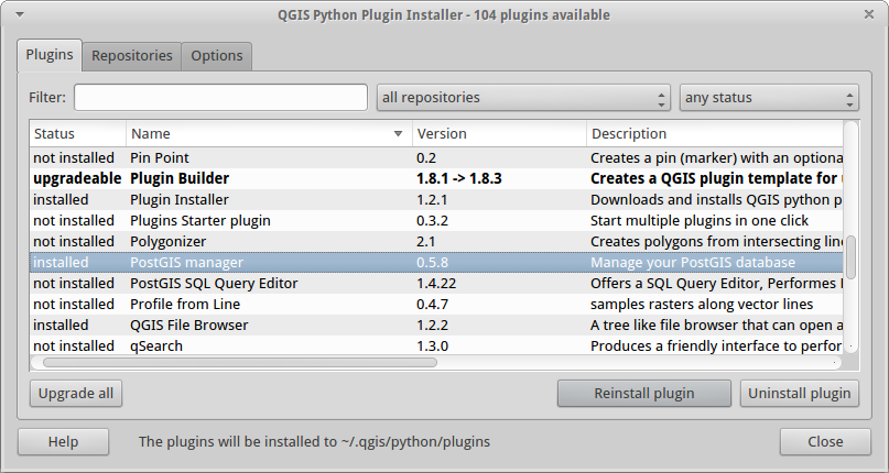

Importing shapefiles to QGIS can be done via a handy PostGIS Manager plugin. To set it up, go to the
Plugins menu, select Fetch Python Plugins
. QGIS will then get the latest list of plugins from the
repository (you will need a working internet connection for this). Then find the PostGIS Manager
and
hit the Install plugin
button.

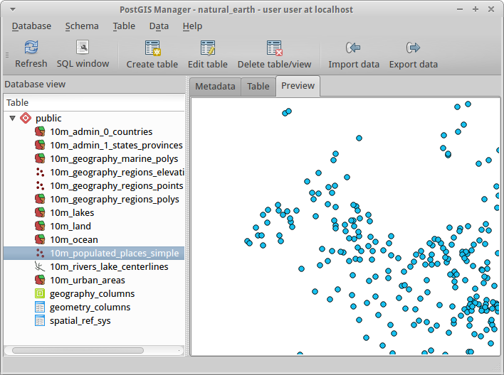

Now on the Database menu you should have a PostGIS Manager entry which gives you an option to start the manager. You can also click the PostGIS logo button (the elephant with the globe) on the toolbar.
It will then connect to the Natural Earth database. Leave the password blank if it asks. You’ll see the main manager window. On the left you can select tables from the database and use the tabs on the right find out about them. The Preview tab will show you a little map. Here I’ve selected the ne_10m_populated_places layer and zoomed in on a little island I know:

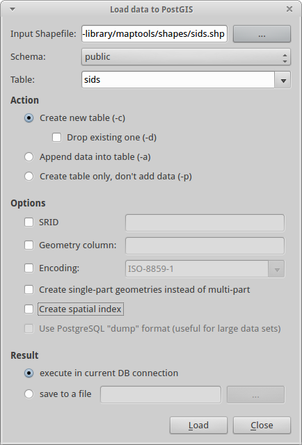

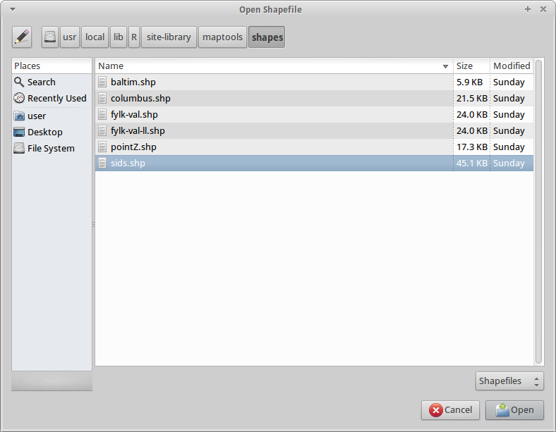

We will now use the PostGIS Manager to import a shapefile into the database. We’ll use the North Carolina sudden infant death syndrome (SIDS) data that is included with one of the R statistics package add-ons.
From the Data
menu choose the Load data from shapefile
option.
Hit the ...
button and browse to the sids.shp
shapefile in the R maptools
package
(located in /usr/local/lib/R/site-library/):
Leave everything else as it is and hit Load
The shapefile should be imported into PostGIS with no errors. Close the PostGIS manager and get back to the main QGIS window.

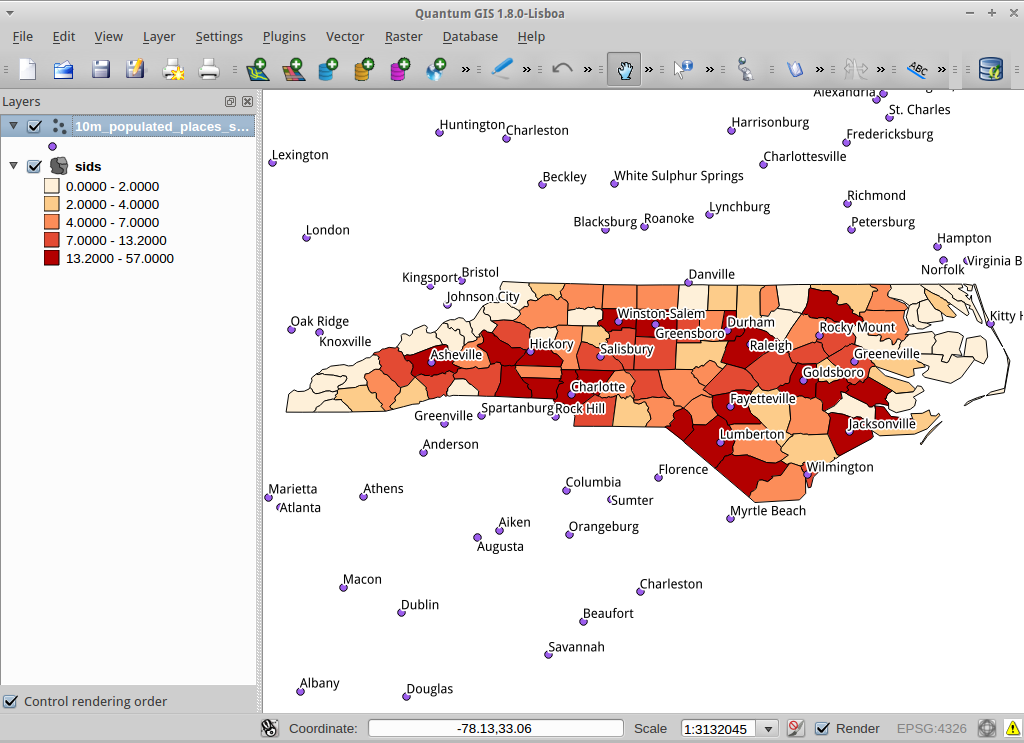

Now load the SIDS data into the map using the ‘Add PostGIS Layer’ option. With a bit of rearranging of the layers and some colouring, you should be able to produce a choropleth map of the sudden infant death syndrome counts in North Carolina:

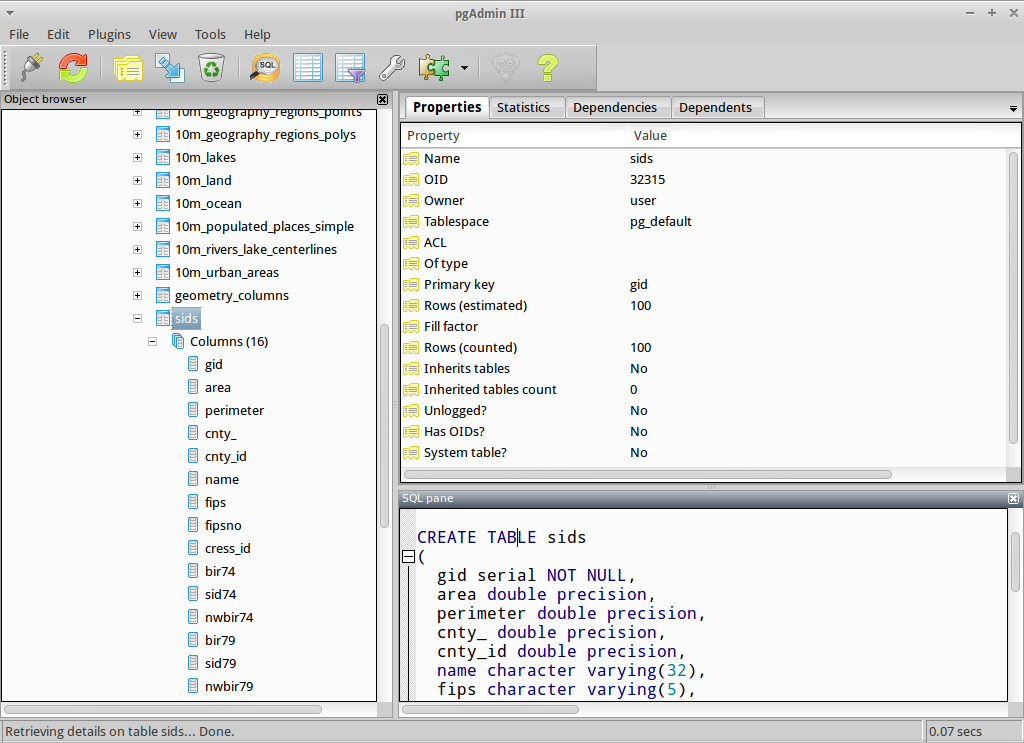

Get to know pgAdmin III¶

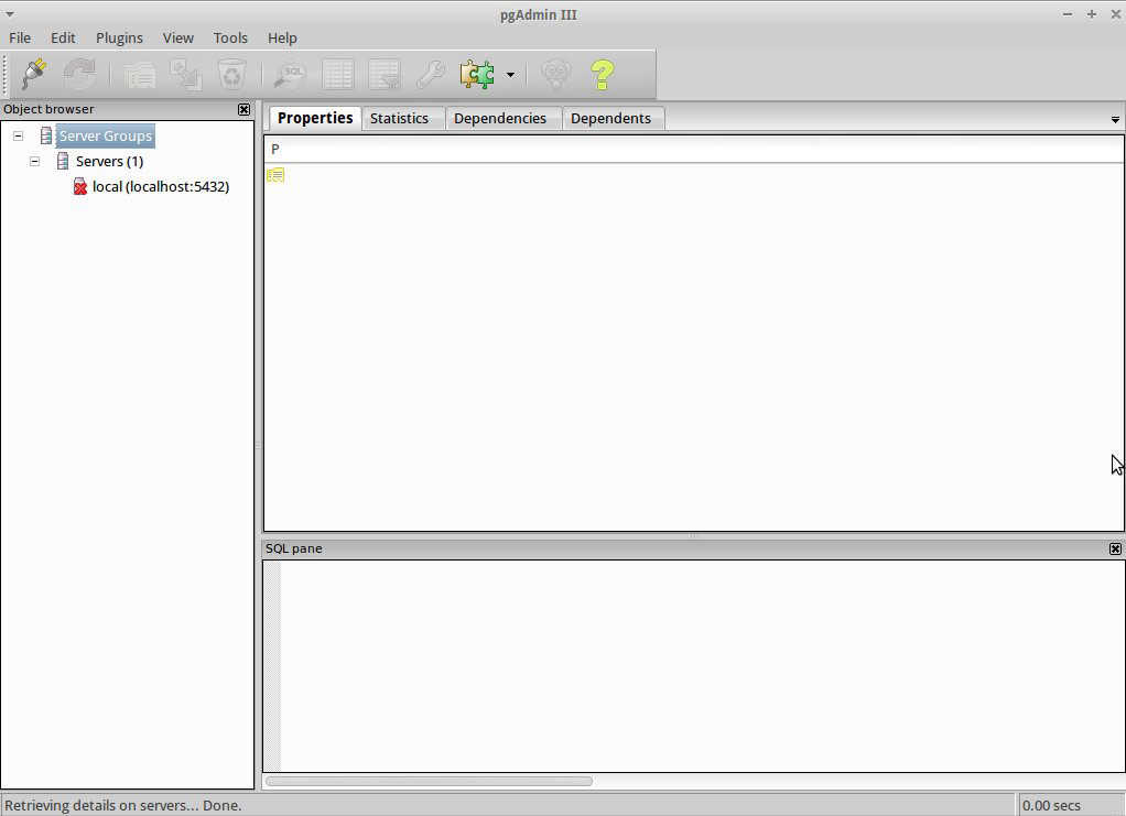

You can use the graphical database client pgAdmin III
from the Databases menu to query and modify your database non-spatially. This
is the official client for PostgreSQL, and lets you use SQL to manipulate your data tables. You can find and launch pgAdmin III
from the Databases folder, existing on the OSGeo Live Desktop.

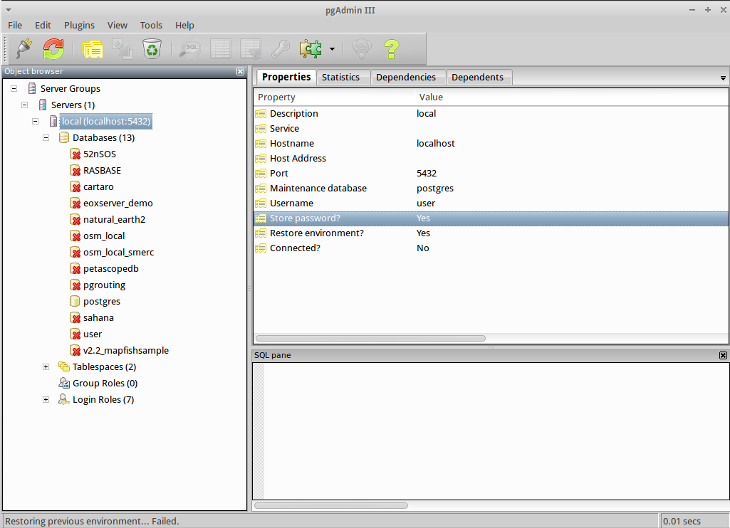

Here, you have the option of creating a new connection to a PostgreSQL server, or connecting to an existing server.
In this case, we are going to connect to the predefined local
server.
After connection established, you can see the list of the databases already existing in the system.
The red “X” on the image of most of the databases, denotes that you haven’t been yet connected to any of them (you are connected only
to the default postgres
database).
At this point you are able only to see the existing databases on the system. You can connect, by double clicking,
on the name of a database. Do it for the natural_earth2 database.
You can see now that the red X disappeared and a “+” appeared on the left. By pressing it a tree is going to appear, displaying the contents of the database.
Navigate at the schemas
subtree, expand it. Afterwards expand the
public
schema. By navigating and expanding the
Tables
, you can see all the tables contained within this schema.

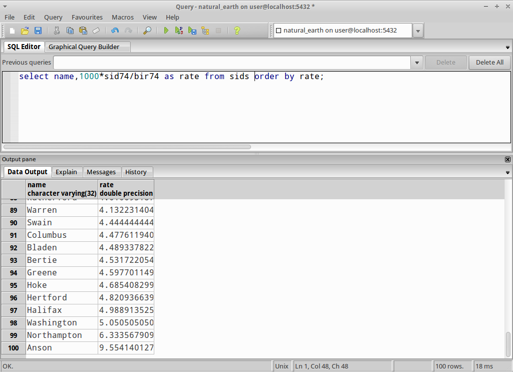

Executing a SQL Query from pgAdmin III¶
pgAdmin III, offers the capability of executing queries to a relational database.
To perform a query on the database, you have to press the SQL
button from the main toolbar (the one with the
yellow Magnifying lens).
We are going to find the rate of the SIDS over the births for the 1974 for each city. Furthermore we are going to sort the result, based on the computed rate. To do that,we need to perform the following query (submit it on the text editor of the SQL Window):
select name, 1000*sid74/bir74 as rate from sids order by rate.
Afterwards, you should press the green arrow button, pointing to the right (execute query).
