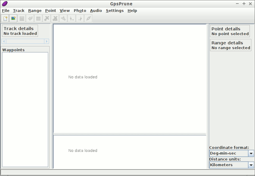

To run GpsPrune on the live DVD, select the icon “GpsPrune” in the Navigation and Maps menu. This will then give you the empty window shown below.

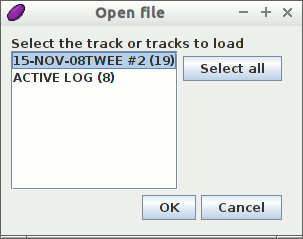

We will now load a file by using the menu command File ‣ Open file and selecting the file to load. This can be a GPX file, a KML or KMZ file, or even a comma-separated or tab-separated file if you have one. A suitable GPX file containing a couple of tracks can be found on the disc at ~/data/vector/R/test_trk2.gpx so we will load this one.
../../_images/gpsprune_trackselect2.png
Because this file contains two tracks, we are offered the choice of which one(s) to load. We choose just the first one and press OK.

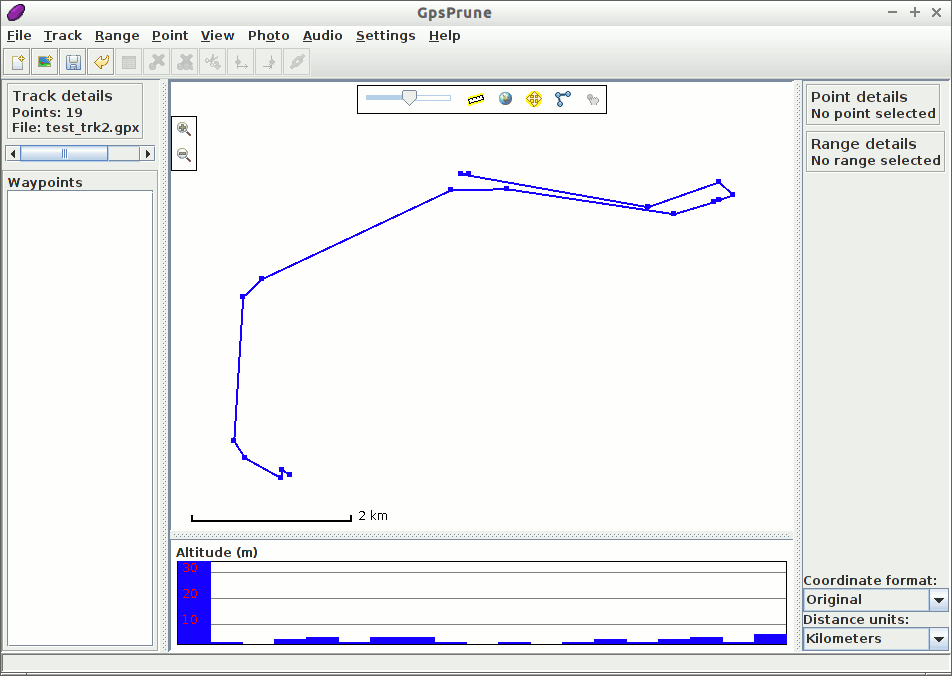

Now you should see the track marked in blue against a white background. If this track had any waypoints (which it doesn’t), then they would be shown too, marked with their names. Below the main map display is an altitude chart, which shows the profile of the track if it contains altitudes.
../../_images/gpsprune_test_trk22.png

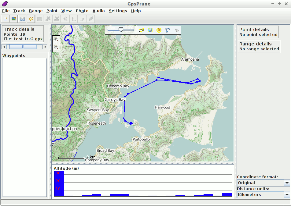

Now, assuming you have a network connection, you can activate the map by clicking the globe icon at the top of the main map display, or with the menu option View ‣ Show Map.
../../_images/gpsprune_mapnik2.png
You can drag the map around with the mouse, and zoom in and out with the mousewheel or the right-click menu to see greater details. Clicking on a point will show the details including altitude and timestamp if available. You can also click on the altitude profile to select the corresponding point.

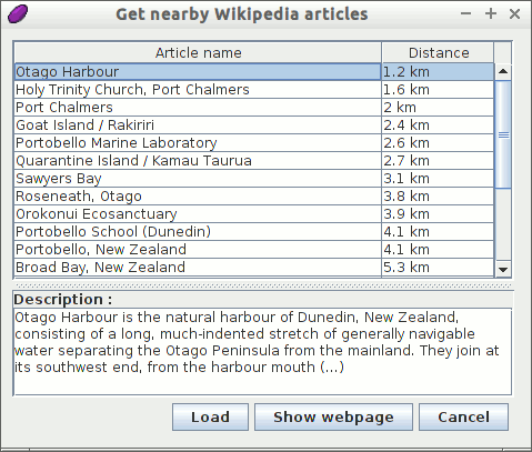

Now let’s find out some more information about where this track is. We can do this by selecting a point, and then choosing the menu option Track ‣ Get nearby Wikipedia articles. This shows a list of articles whose coordinates are nearest to the selected point. Clicking one of these entries in the list will show more information in the box below.
../../_images/gpsprune_wikipedialist2.png
You can then use the button Load to load that point into GpsPrune, or Show webpage to load the Wikipedia page in a browser.

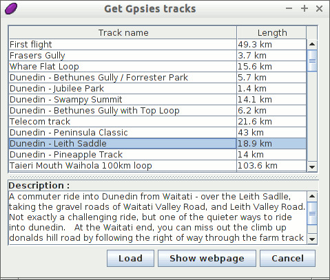

Finally, let’s download another track from the same area. We can use the menu command Track ‣ Get Gpsies tracks to search for tracks on the website gpsies.com. Again, we get a list of matching entries, and we can select one to view the description.
../../_images/gpsprune_gpsieslist2.png
Click the Load button to load the track, and select to append this track to the data we’ve already got. Now we can see both tracks in the same view.

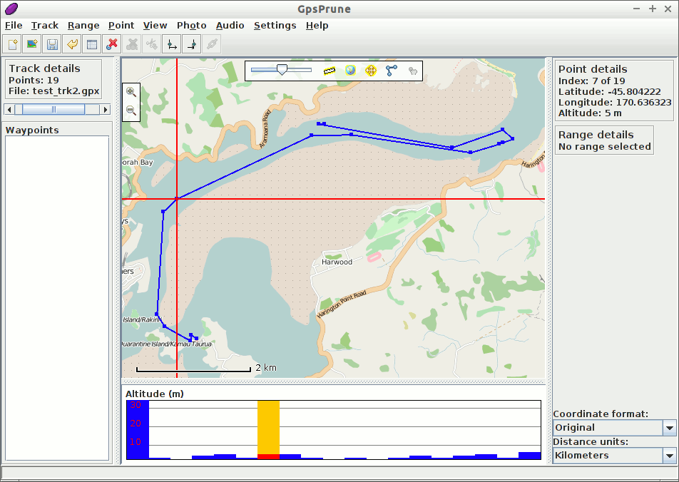

To find out how long the climb is, we’ll click on the point at the start of the climb, just north of Dunedin, and select Range ‣ Set range start. Then select the top of the climb by clicking on the highest point of the altitude profile, and select Range ‣ Set range end. We can now see in the “Range details” section that this part of the track is 8.55 km long, climbs 346 m and descends just 10 m.
