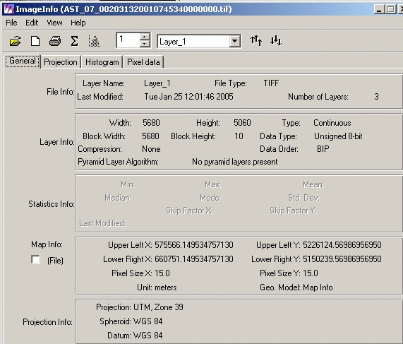

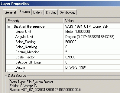

ImgImporter georeferenced GeoTIFF can be easily opened with ERDAS IMAGINE, ArcGIS and Arcview GIS software. No additional steps for setting georeferencing is required (see examples).
